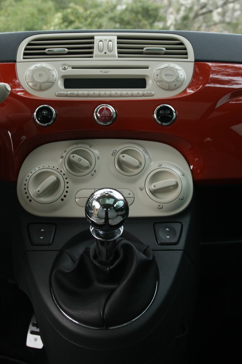

Et voilà le résultat.
[img]http://img516.imageshack.us/img516/6984/34689138.jpg[/img
[img]http://img165.imageshack.us/img165/1862/70008234.jpg[/img
